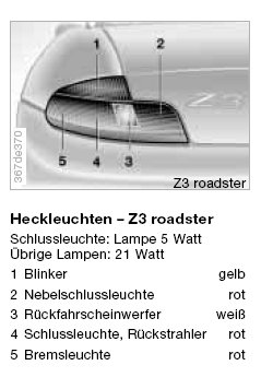

Hello everyone, finally was able to get a rear lamp assembly for a euro z3.
Here in the states we do not have a rear fog light so I am adding that feature.
It seems bmw did some playful wiring on this model z3
in the below picture there are numbers 1,2,3
Will someone do me a favor and tell me what 1,2,3 actually do on the euro spec model, i know its rear fog ,brake and driving but I want to confirm which actuall order it is in
thanks so much
max
http://www.zroadster.net/forum/download.php?id=3603
AW: 2000-2002 Z3 tail light help
1 Fog
2 Brake
3 Light
Good luck!
nn

nixnuz thanks
Im hoping some more people answer that have a 2000-2002 roadster, I trust what you are saying but im getting different answers from other lol
Since there is some wiring I have to do, I want to make very sure which is which
anyone else have any input?
1 Fog - 2 Brake - 3 Light => Sorry guys, that`s wrong!!!
1 is Fog; 2 is Light; 3 is Brake;
You also can see it in the german operating instructions -> look at the picture I've put from the operating instructions.
My neighbour has a 1.9 roadster, and I've changed a lamp for him 3 days ago.
Olaf
