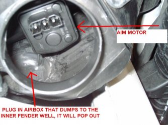

Im in the process of adding the euro aim control that is factory on your cars, when I had the drivers side headlight out I see a plug in part of the air supply system. the plug is made to be popped out and it looks like a hose is supposed to be hooked into it. below are some pics to show you want i mean.
if any of you ever have your air box out or the drivers side inner fender will you please take some pics for me
thank you so much, I can paypal you some money if you have to remove the air box which takes about 5 minutes:)

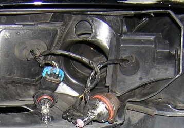

Hi 01silvz3texas,
either this or next weekend i will (hopefully) disassemble the front bumper while recovering from a little accident not worth going into further detail with...
Doing so, i will remove the left headlight. I will make the pictures and post 'em here so just wait...

Hi there,
here is a photo that shows the connector to the aim control (left headlight ist removed). I also sent you the circuit diagramm via eMail.
Good luck.
Nixnuz
Edit: just see your mail-address is hidden. If you need the circuit diagramm let me know.
