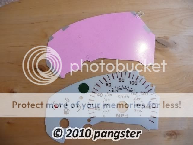

I guess this is when the arty/craft part of the project begins! My Lockwood dials came in 2 separate halves which made this slightly easier as I was working with 2 x EL panels (1 for each side).
Take your new dial and offer it up to your EL panel:
You need to decide the best position for this. Bear in mind that when you're cutting round the EL panel you need to leave yourself a pair of connectors to connect to!! i.e. do not place the gauge in the middle of the panel and cut round it! NB where you also see the silver strips on the edge of the panel, these are non light emitting so also bear this in mind!
I position min at approximately 45 degrees on the panel which meant that I had 2 connectors coming out from the top (round about th 100 mph mark) as can be seen here:
You'll also note from the above that I have a silver strip in the bottom left hand
er (this is fine as well as there is nothing that needs to be illuminated here).
