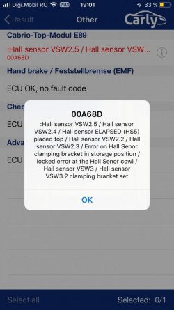

Today I've repositioned today the inner seals (window seals) because I was having some small leaks.
While I was working, the rear part (the heated window in the back) slowly started going down (which was normal). I went in the cabin, and pressed the buttons to lock it down but I've got an red roof symbol in the dash. Diagnosed it to an A68D error (microswitch or cable error I think). I wiggled the cable area a little bit, managed to get my rear part up on top, tried to close, didn't work, pulled out carly, cleared all error codes, and then i've managed to close it.
Do you have any ideea what might have caused this? Should I cut the protection that is above the wirring to check for the broken cables?

P.S: I've ordered parts 2 & 3 from here (might as well switch both if i'm taking the hard top down)
I think it's going to be enough to switch the bad cable out.. should make the hardtop work for a few more years, right?
