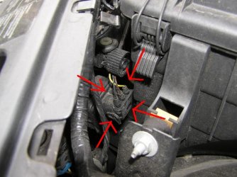

I am adding the euro headlights with the aim control system, I finally was able to get the lights here:) Would someone please take some picture for me of what route the wires take and just some all around photos of the headlights with wires and such

I try to do my best B;

Yes there should be a part number on the connector that connects to the aim motor, if you can see it that would help a alot , thank you

ok great here is a picture of the connector i need the part numbers from
if you see any numbers at all write them down for me please, even if they are a AMP number. the passenger side one should be easy to unplug and look at the whole connector for numbers:)

Max,
there you have a problem: All German Zetties were factory equipped with 'aim control' - it's law here. Therefore, the entire wiring for this is part of the main loom and not available seperately. I was looking for that connector - couldn't find it but I'm in a rush. The connection point is X1034 in the wiring diagram and I'm sure somewhere there (diagram) will be more info about it.
As said I'm running out of time so I'll try to send you the entire diagram if I can find your priv. email address. I hope you got a speedy line - it's 5.8 MB! - and in German!
