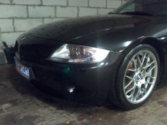

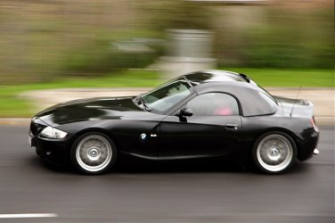

I have Votgland, the springs lowering the car 30mm (so is writen) but the car comes 40mm lower (I have 3.0 motor, with the 2.5 i thint it will be lower ~35mm). On the rear axel I have also the offroad-package of the E46. On the foto you can see that when I`m siting in the car is it very goog in the line at teh front & raer axel. Without the offroad-package will be the rear axel more lowerder then the front axel and it will look like "Jokin" has writen a pig, what has eaten too much. The problem in Z4 ist that the pasengrs are siting very near the rear axel, in for example E46 the pasengers are siting in the middle of the car and the all car comes lower, by Z4 only the raer axel.
AW: Lowering my Z4 - Help wanted in english
Foto:
