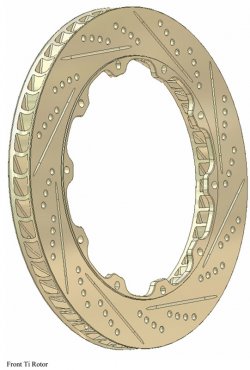

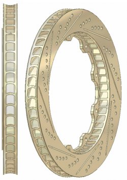

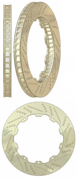

As carbon ceramic rotors need extra cooling to work optimally and as, in any event, they seem a bit out of place on the Z8, I have been working on titanium rotors. Assuming that one already has the Brembo brake upgrade (380 mm x 32 mm front, 345 mm x 28 mm rear), the titanium rotors should save a total of approximately 28 pounds (12.7 kg) of rotating and unsprung weight over that kit, i.e., 6 to 7 pounds per corner (2.72 kg to 3.17 kg). Of course, the new rotors will work with the Brembo bells (hats).

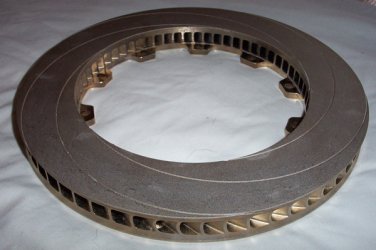

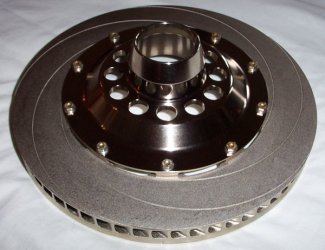

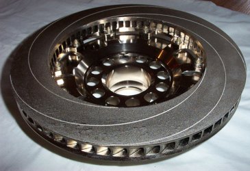

Some actual examples.
