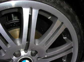

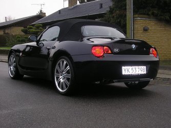

I bought a Z4 a few weeks ago with 19" alloy wheels. Can anybody help me indentify the wheels, i.e. size, ET and brand. The tyres are 235/35, but is it possible to have 255/35 or even bigger mounted?
IQ-Man mounted the original M3-rims, they have 9,5x19ET27 - my rims are 9,5x19ET39 ... these 12 mm have the rear body to be wider.I think IQ-Mans Z4 are too wide at the rear, but maybe it is because he has mounted spacers and he is using the wrong ET ??
What I want for my own Z4 is wider wheels at the rear like 9,5x19"?
Regards
Z4 Denmark
. I have ordered The Eibach springs and the offroad part, which will lower my Z VA30mm and HA20mm- that will be step one. Second step will be 2x20mm spacers. Third step (will only be relevant if I'm not happy with the with of the rear wheels): remove the spacers and mount 9,5x19" with 265/30R19 tyres.

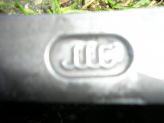

. It is not original M3 wheels, but a copy. I need to know who have produced them. Here's som data from the wheel:
