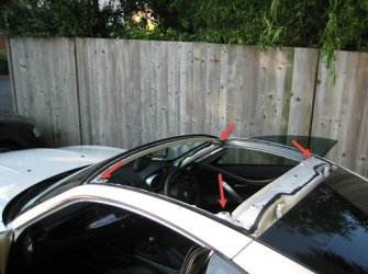

I have same Issue on my E86 "loud rattling" from above I think, sorry but I have hard time to understand which screw you talking about, 4 of those holding actual roof?
Maybe because of translation from german to english
That's right, these 4 screws will come loose. Removing the headlining is no problem. Best is to screw in all 4 screws with loctite.
