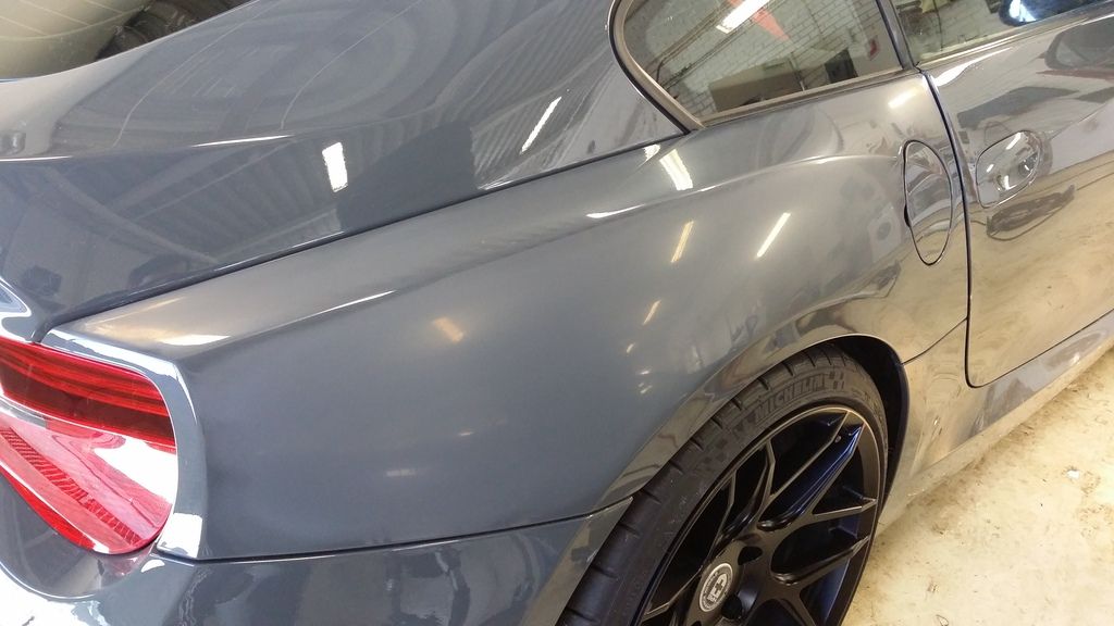

I`m now close to completion, just doing some finishing touches these days:)
So used the weekend very well, and wet sanded the whole car. Hood got 1500 grind, then 3000. Rest of the body just 3000, wanted to have som clear to play with later:D
Did you remove the orange peel at all now?
It looks great.
