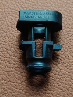

So if the small, black plastic sensor holder was removed. How does the sensor hold now? đŸ€”
You don't have an image of this, do you?
I think it is only part of the holder, of course the (electrical) connectors on the car side and the sensor side are still there.
See the attached picture for the part they removed (just plastic, no electrical parts inside, looks only used to extend to a certain position?).
Could not find the BMW part number, but maybe you can? (BMW 5111 5A3B8E0-03 114609 2U925-01)
So it looks a different part then number 2 shown here: Temperature sensor Also it is not part number 1, but it might be that part 1 includes this plastic holder?
Here more pics of the official sensor (part 1 and 2): Fits BMW Z4 E85 E86 E89 G29 Z8 E52 Outside Ambient Temperature Sensor 6936953 | eBay
Don't have pictures of the new config under the bumper (beware, on the RIGHT, passenger side, so not on the left, driver side, as shown in some of these pics!), but maybe some of the other people who solved this problem know more?

Ich hab noch nicht verstanden welcher Halter funktioniert.
1.
holder-temp-sensor-jpg.615640
2.
Photo 1 ist der plastic halter von mein Z4 der rausgenommen ist.
Photo 2 zeigt der temp sensor (part no 1) und der connector (part no 2), der - glaube ich - Beides notwendig sind?
