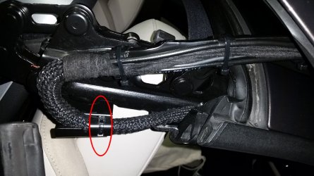

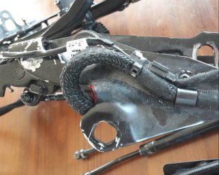

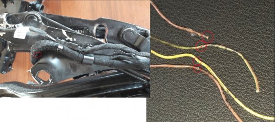

@RobbiZ4, In Your 1st photo (4 wires cut) it looks like the were cut sharp - I suspect this area is responsible for that (marked by red circle in left photo):

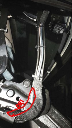

I made more space in this area + I secured sharp edge (marked in red below) using few layers of rubber tape.
You can see a bit of rubber tape in this area (T-marked area)
Well, there are additional zip-ties in the lower area.

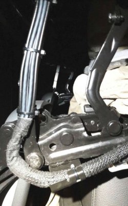

As I can see on your first picture, you have removed the lower zip-tie, marked in red on my following picture.
Did you replace it later in the car? What about additional zip-ties in the lower right area (front roof plate)?
Yes - I replaced this zip-tie. Additional zip-ties are not needed.

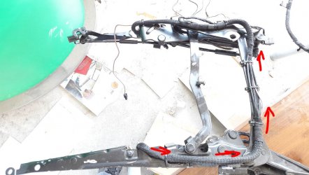

There is right side in picture below - I tested, how much surplus I needed (in this picture is too much - then I moved a little upward, to create more surplus in upper area).
Note: all zip-ties in this photo are new.
