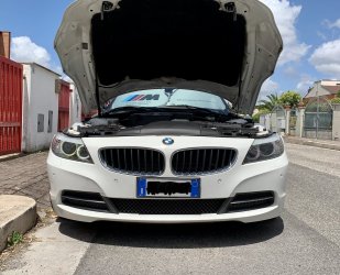

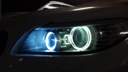

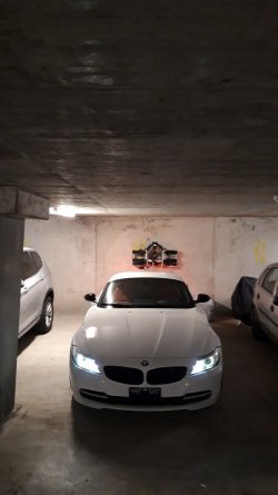

my experience in the installation of the Philips Ultinon Gen 2 could be useful
I installed the Philips ultinon gen 2 in my Z4, I replaced my "blue" halogen.
The installation was quite laborious, nothing impossible, but certainly not simple,
even if conceptually you have to follow these steps:
  1. Remove the heat sink by loosening the "small dowel screw" (I have not completely removed the screw) and slide it near the LED driver;
  2. Insert the lamp carefully, you will have to find the right angle because it remains long without the heatsink;
  3. once inserted, try to fit it in its seat to lock it;
  4. slide the heat sink over the cable and screw it back to the LED lamp (this is the part that took me the longest time because space is really limited);
  5. Insert the LED driver and connect the terminal.
for both lamps I also took about an hour and a half.
The result in my opinion is very good especially compared to the first halogen lamp,
the angel eyes look very good, but in the picture I can't take them well because they flicker a little on the cell phone camera,
but I assure you that under the midday sun they can be seen very well, while with the halogen the external circle is not illuminated
Now with the Philips the outer circle has a slightly yellowish color compared to the inner one, but really nothing to suggest that it is not worth the effort.
The insertion and possible removal (if needed) are the only things to seriously consider before purchasing them.
in my Z4 I didn't need to remove any errors from the lamps, the system accepted them once the old halogen lamps were replaced.
I have never used an OBD to modify anything in my car.
in this photo I compared the Philips (left) with the halogen "Blue",
under midday sun the ultinon is great, and the halogen seems turn off

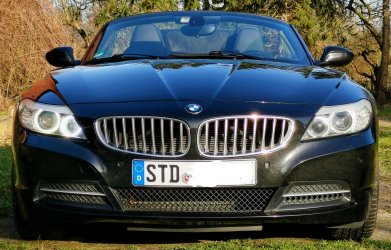

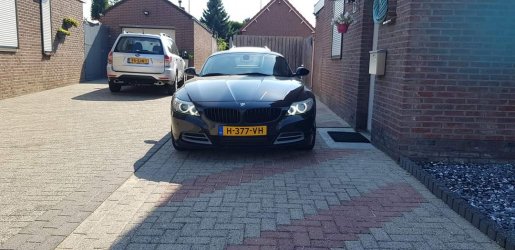

Habe gerade die neuen ultinon essential eingebaut, sieht super aus und auch sehr gut sichtbar bei vollem Sonnenlicht. When man den Dreh raus hat dauert er nur 10 min um beide ein zu bauen. //www.philips.nl/c-p/11366UE2X2/ultinon-essential-led-koplamp#see-all-benefits

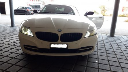

Hallo zusammen,
ich habe auch die Philips X-TremeUltinon 6500 LED´s verbaut, ich finde jedoch das sich ein ganz schöner Farbunterschied abzeichnet zwischen
dem Inneren und Äußeren Ring, der Ring Außen erschein richtig gelblich.
Ist das normal?
Gute Fotos zu machen ist schwierig, der Innere Ring ist so grell das auf Bildern kein Unterschied zu sehen ist.
Der Vorbesitzer hatte so billige LED Funzeln verbaut, die Helligkeit auf max. gestelt, kann es vielleicht daran hängen?
Danke vorab
Thorsten
Moin Thorsten,
Nö, das ist normal. Von vorne sieht es stimmig aus, aber von der Seite ist es schon sehr unterschiedlich. Hab auch die Philips drin und durch drehen versucht ob sich da was ändert, tut sich aber nix.

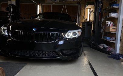

Hallo werte Forumsmitglieder! Ich habe letzte Saison auch auf die Phlips Xtreme Utinion gewechselt und war von der Lichtkraft und Helligkeit eigentlich zufrieden... habe aber ein anderes Problem. Ich kaufte mir die Leuchtmittel schon nachdem ich festgestellt hatte, mit anderen Lampen, dass mein äusserer Coronaring auf der Fahrerseite viel schwächer als der äussere Coronaring auf der Beifahrerseite ist. Daher vermute ich ein eventuell durch Hitze entstandener Schaden an dem Ring selbst.
Nun meine Frage, kann man den Scheinwerfer mit mittlerem Aufwand selber aufmachen und die Ringe ersetzen? Danach wieder abdichten, kleben etc.
Oder soll ich stattdessen lieber einen neuen Scheini kaufen, bräuchte ja dann nur das Gehäuse ohne Stellmotor, Xenon-Brenner etc?
Dieser z.B.:
HELLA Hauptscheinwerfer Bi-Xenon für BMW Z4 (E89), links | eBay
Ich kann mir nicht vorstellen dass das ein Hitzeschaden sein soll. Ohne es gesehen zu haben aber schwer zu beurteilen. Hast du mal geschaut, ob das Leuchtmittel richtig eingerastet ist? Im Idealfall mal mit der originalen H8 testen, ein bauartbedingter Helligkeitsunterschied zwischen innerem und äußerem Ring ist normal. Gleich einen komplett neuen SW zu kaufen ist vielleicht die radikalste Lösung.
Scheinwerfer öffnen, reparieren und wieder "zusammenbauen" funktioniert nicht, entweder beschädigst du ihn beim Öffnen/Schließen oder er ist danach undicht 😉

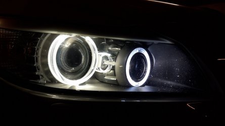

Ich hatte das Problem mit anderen Leuchtmitteln wie gesagt auch schon und wollte es eigentlich mit den neuen Philips ausgleichen. Der Fehler ist aber mitgewandert. Ich werde es mal versuchen zu fotografieren.
Evtl. ist der Lichtleiter gebrochen. Der Scheinwerfer kann leider nicht geöffnet werden. Habe auch schon mal geschaut, weil ich die Linsen reinigen wollte. Beim E85 ging das noch.
Ich würde mir einfach einen gebrauchten Scheinwerfer kaufen. Beim VFL sollte das recht günstig sein - so um die 150 Euro ungefähr. zumindest habe ich damals so viel bezahlt nach ein paar Wochen suchen.
Schwierig es zu fotografieren. Ich hoffe man kann sich in etwa ausdenken wie es in Wirklichkeit aussieht, auf der Fahrerseite deutlich schwächer.
Fahrerseite, schwächerer Ring
Beifahrerseite, "normaler" Ring
Wenn du die H8-Lampe ausbaust siehst du eigentlich recht gut ins Innere des Scheinwerfers rein. So ist der Aufbau des Lichtleiters, evtl. hat sich bei dir die Verbindung am oberen linken Schnittpunkt gelöst, bzw. das Leuchtmittel sitzt nicht 100%ig. U.u. strahlt die verbaute LED auch unglücklich auf den Lichtleiter. Du kannst ja mal die Lampe entriegeln und in der Fassung bewegen, evtl. gibt es eine Position in der die Ausleuchtung optimal ist, dann lässt sich ein Defekt ausschließen.
