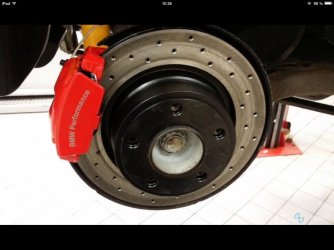

Done some new installs to the Z again :P
The rear H&R adjustable sway bar... I allreay have mounted the 27mm Z4M front sway bar. Poly bushing to the front and rear sway bars as well.
The rear sway was adjusted to it's firmest setting, making it more oversteered for some drifts :D
Also got me some new front control arms. They are Z4 M-sport for track use. Stiffer bushings and a little different angles. Don't know how much, but will do a new alignment soon. Then I can see if there are some changes to the stock ones :D
